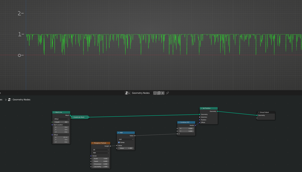

    No need to be sorry! I’ll try to explain; first take a look at the output of the Musgrave with 1.18 added to it:

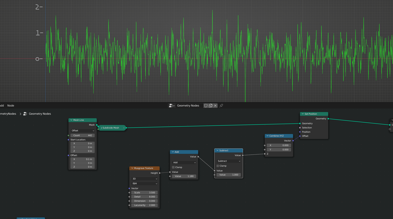

    The AO Node, after it’s been piped through the clamped Map Range Node gives values between 0 (much occlusion) and 1 (no occlusion) and these values are being subtracted from above result. When you subtrat 0 nothing changes and when you subtract 1, it shifts down like this:

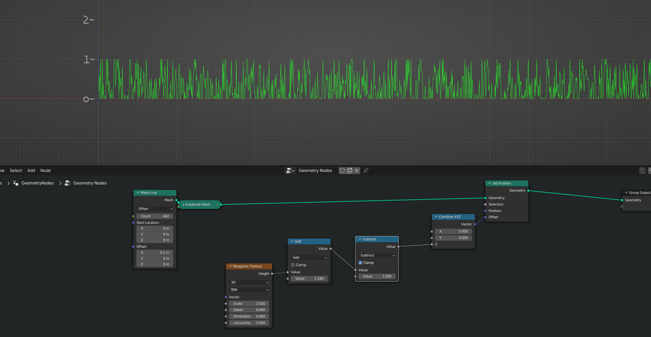

    And clamping the Subtract Node gives:

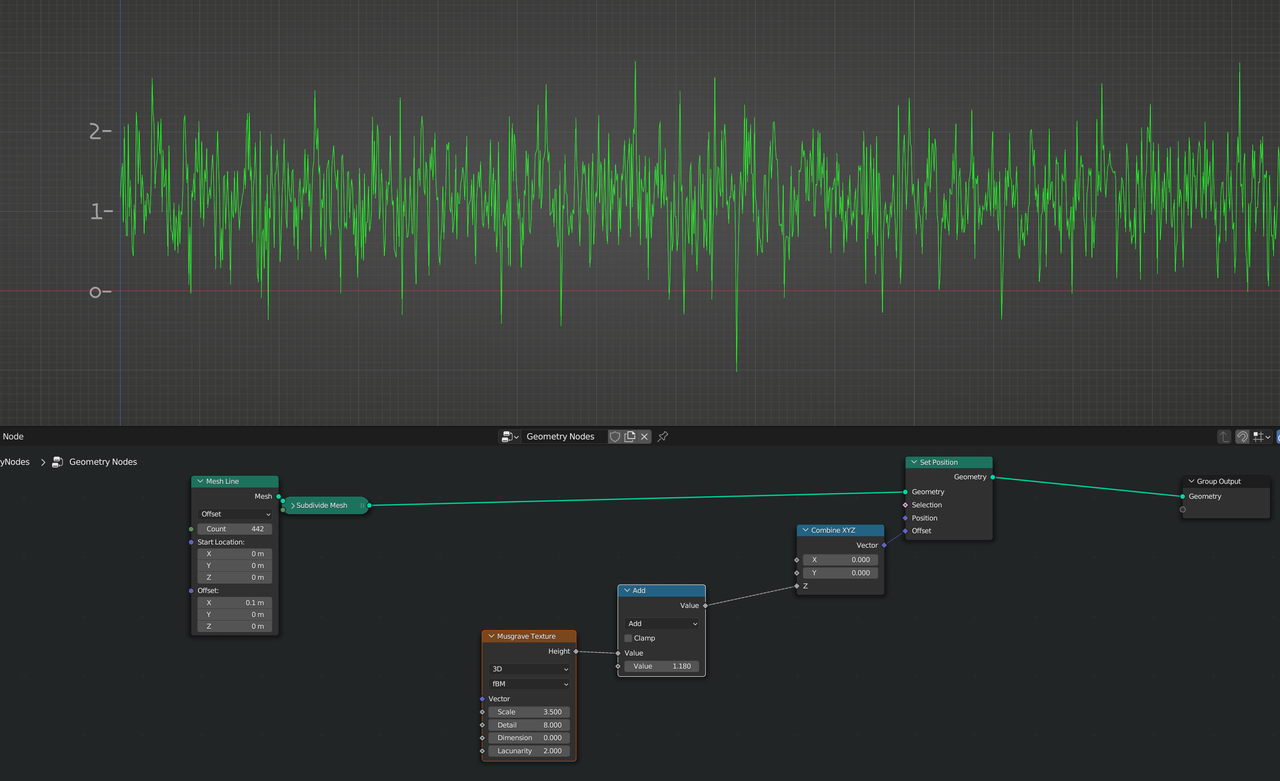

    If we clamp the Add Node we get (before subtracting the AO):

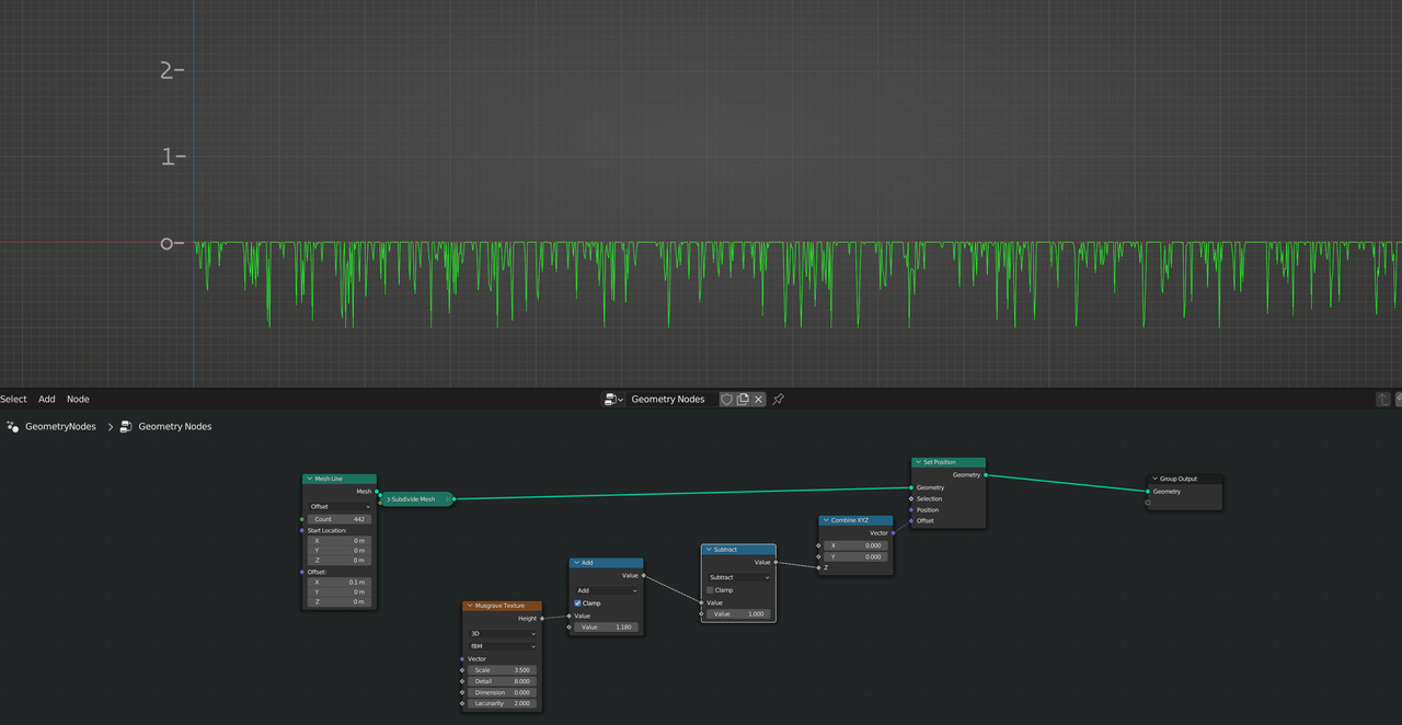

    If we now subtract 0 nothing happens and when we subtract 1 (no AO), we get:

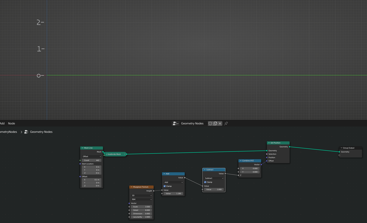

    and then clamping the Subtract Node:
