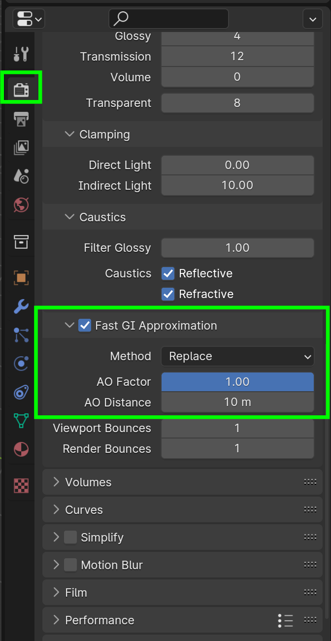

    Hi Christian @mightpossibly ,
    It’s hidden in the Render Settings now:
    This was made with 2.82, so a lot of things have changed (but not the principles)…You can always use the Version used in the Courses, so as not to get overwhelmed by the differences…
