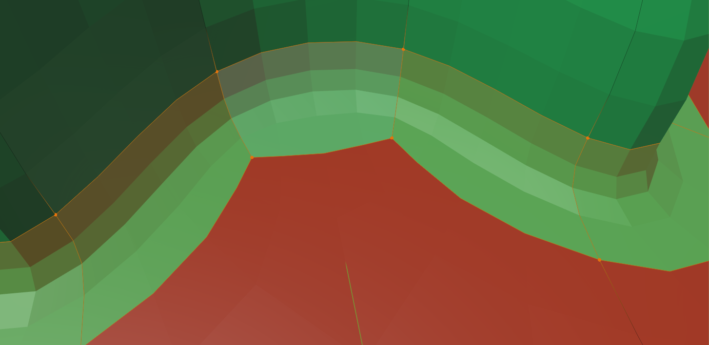

    Hi Jonathan!
    That has indeed to do with the Subsurf Modifier.

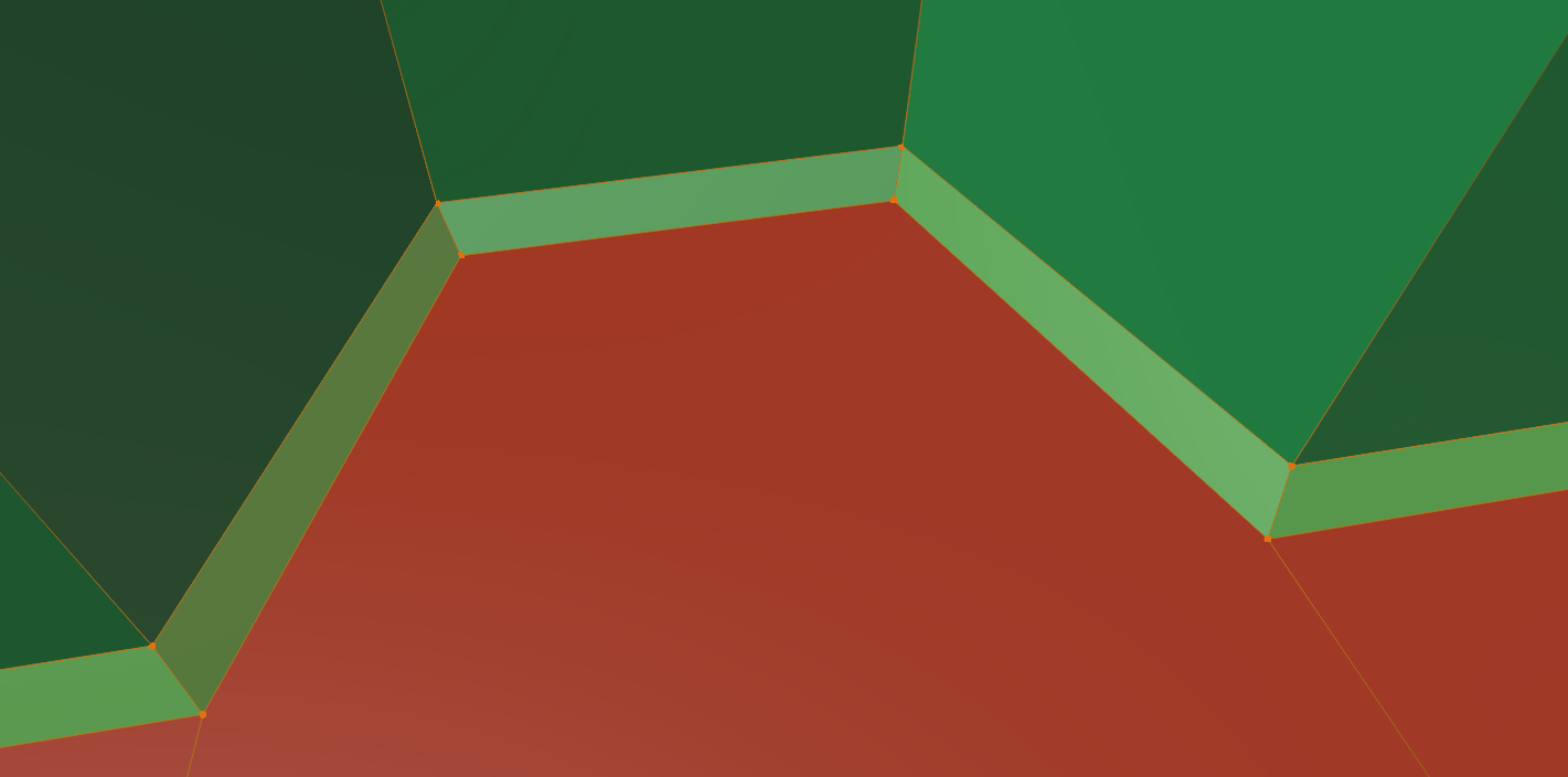

    It looks to me that you have a very small bevel on that edge with 1 segment, something like this (exaggerated):

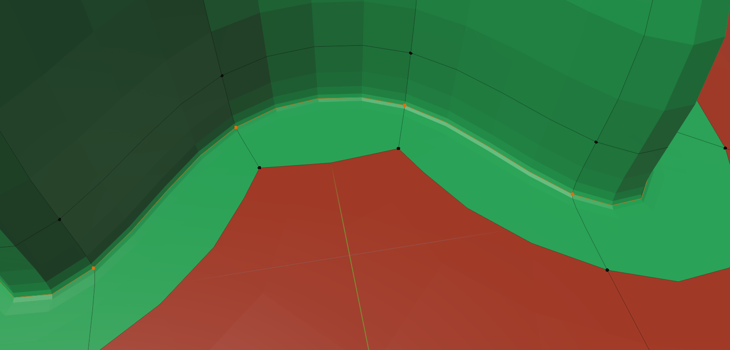

    Which subdivides like this:
    Because it has only 1 segment, it also has only 1 color.

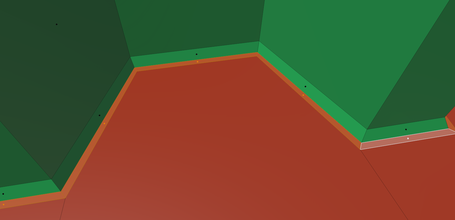

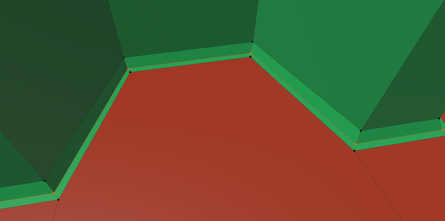

    You will need another edge loop:
    Which subdivided looks like this:

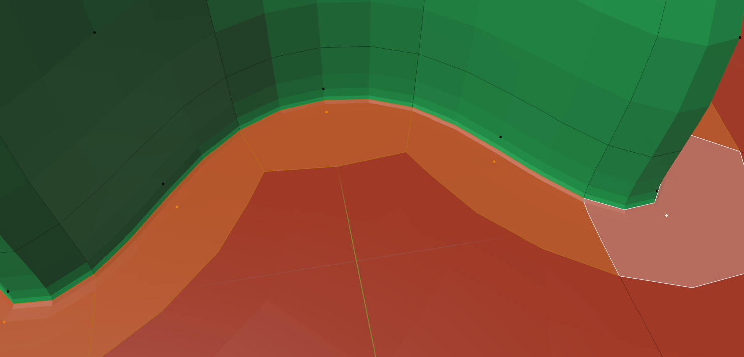

    Then assign the right material here:
    And you get this when subdivided:

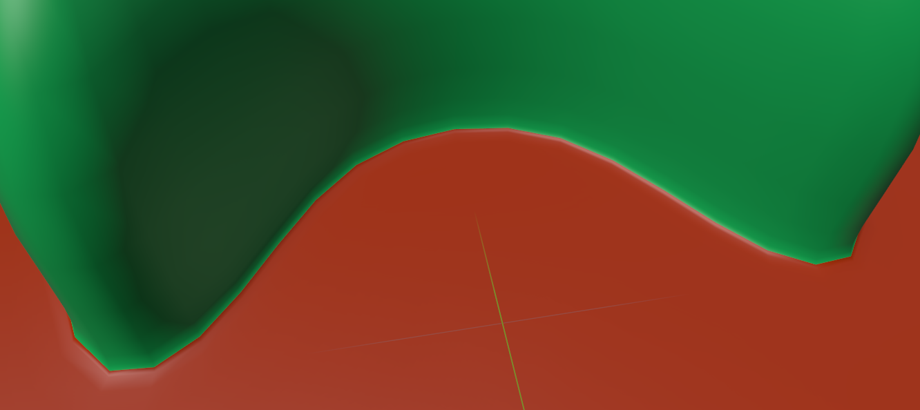

    Or in Object Mode, with Smooth Shading:
    It’s a bit difficult to explain, but I hope it is clear from the pictures.
