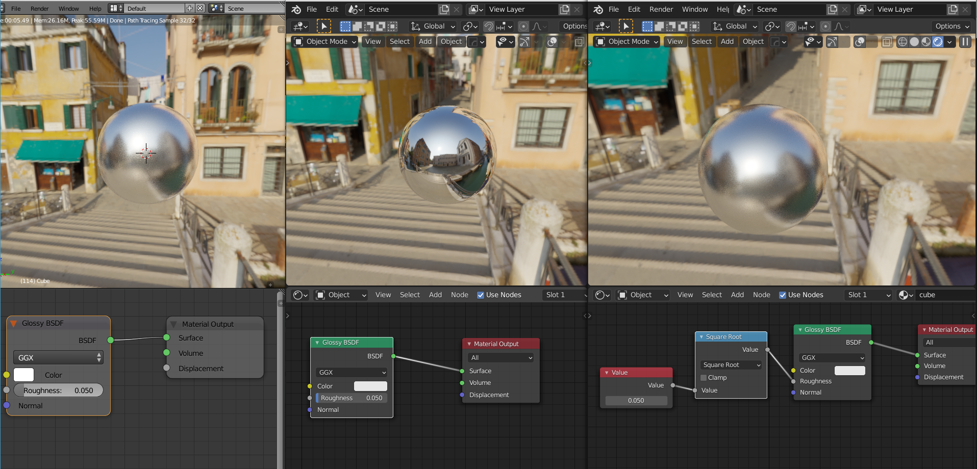

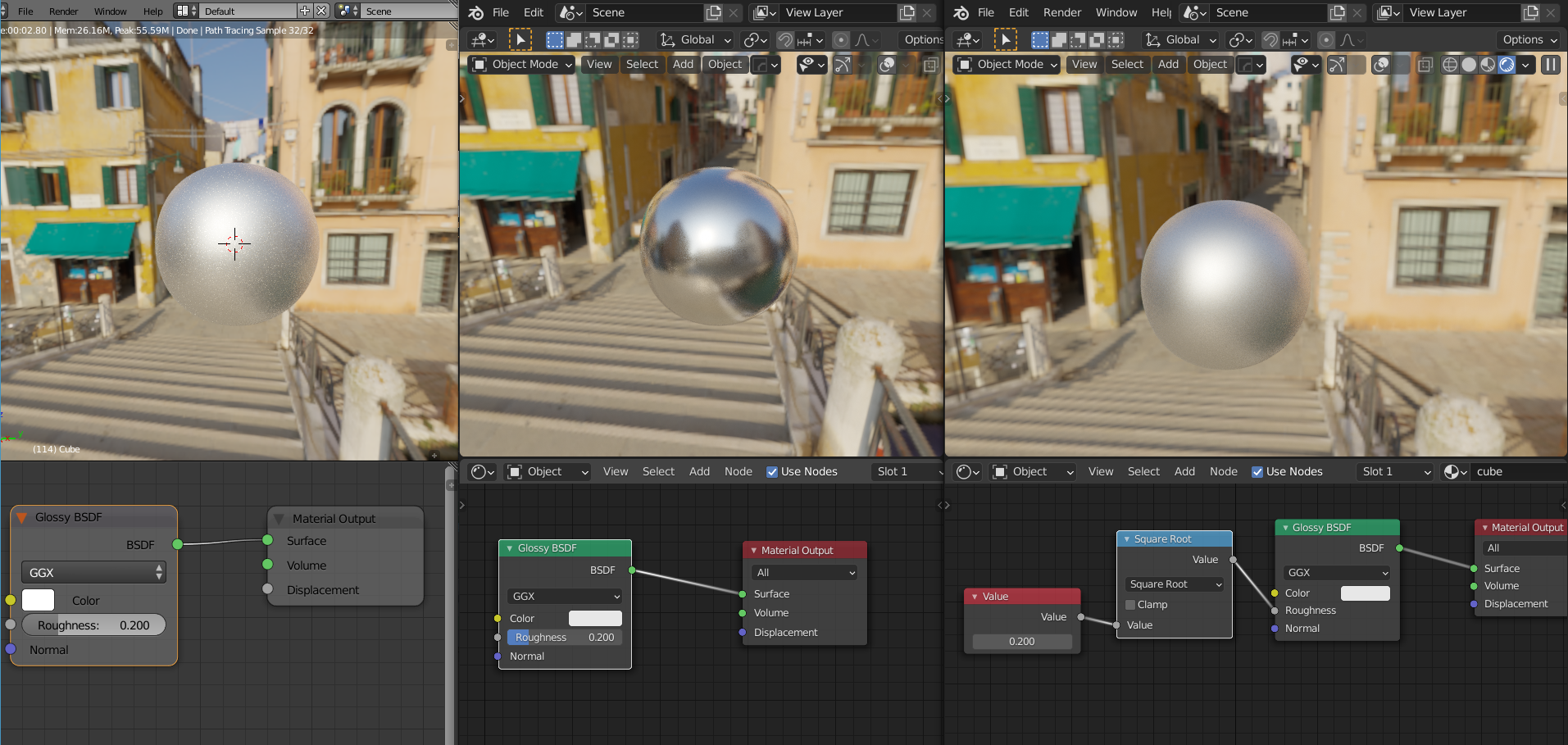

    Hi @cjolson You appear to have stumbled upon something here!
    What has changed is not the Colorramp, but the Roughness of the Glossy Node.
    I did some tests and I might still be a bit off, but when you insert a Math Node, set to square root, between the Colorramp and the Glossy Roughness, you should get a similar result to the tutorial:
