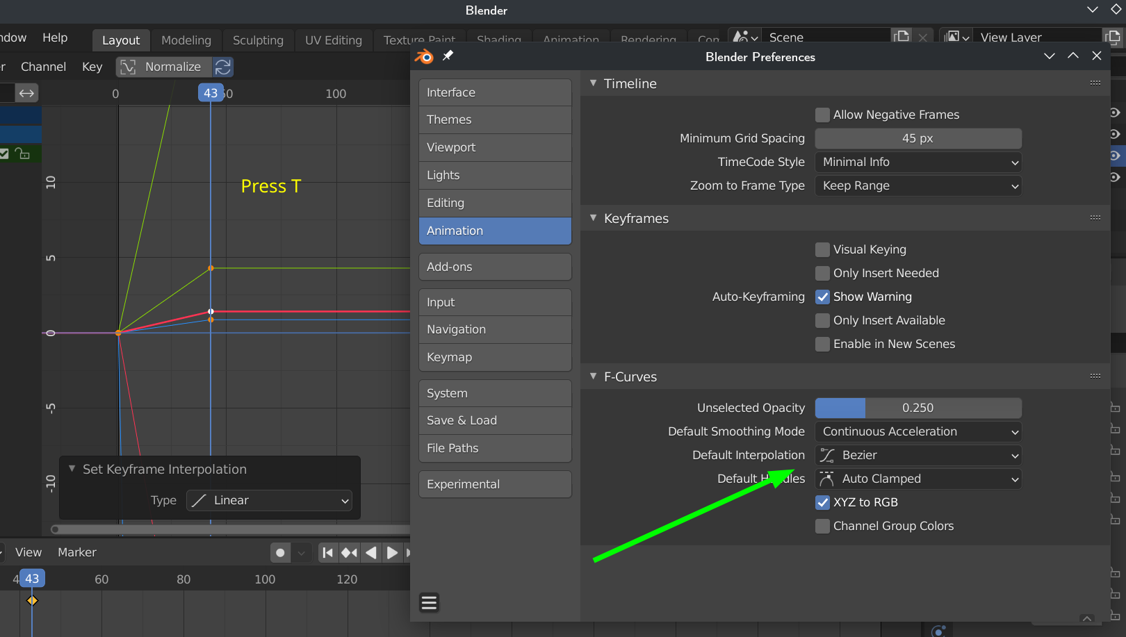

Do you mean the interpolation between keyframes is lineair?
Then use T to set the interpolation method to Bezier. Also check the default method in your Preferences.
If you mean something else, please post a screenshot of the issue.
