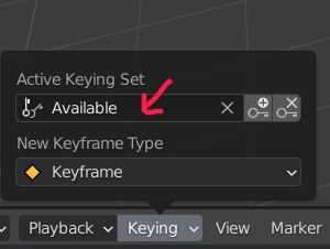

    yeah the UI has changed a little.
    Both the options mentioned below are in the timeline header but here is the keying set location.

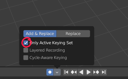

    And then there’s now a dropdown next to the auto-keying enable button
    You need to make sure you have “Only Active Keying Set” enabled over there.
    Hope that helps.
