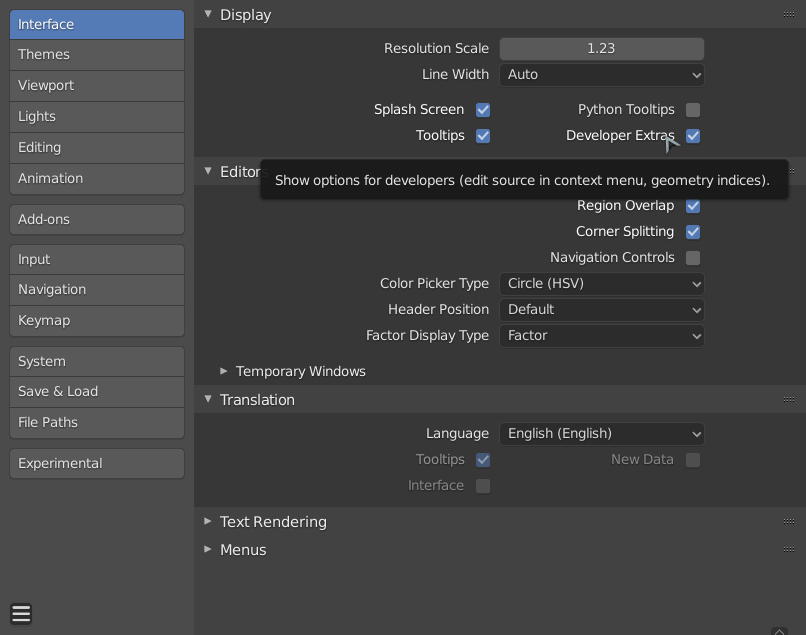

    Or you can check Developers Extras in your Preferences:

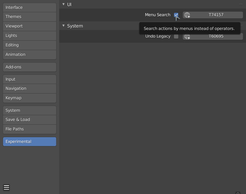

    And then in Experimental use Menu Search:
    This last option is now default in 2.90, so the problem doesn’t arise there (the developers must have noticed something was wrong…)
