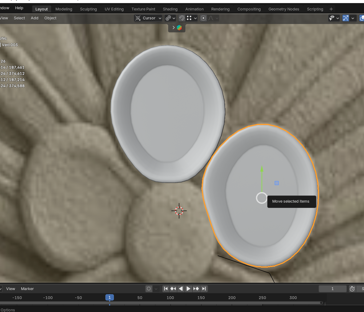

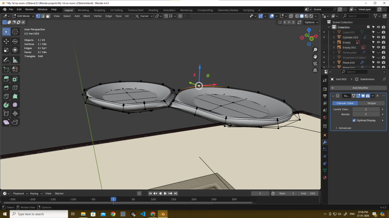

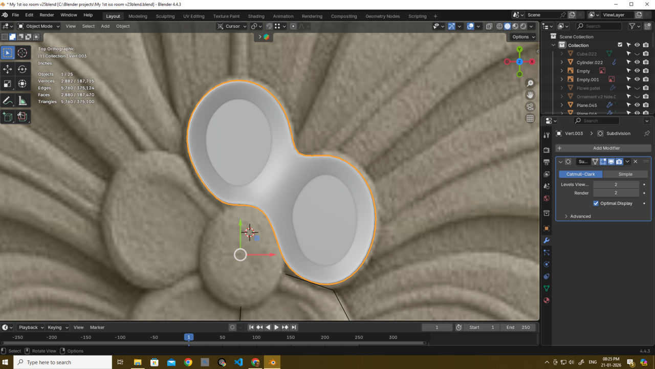

      I’m trying to finish my ornament, but it’s a bit embarrassing to say that I’m stuck on one of the simplest parts because I can’t figure out how to model it.
      I’m confused about how to create this specific part. It looks like a smooth, rounded silhouette or shape,
      but it needs to be modeled in a way that doesn’t overlap and fits perfectly next to the other flower petals.
      If I make it too rounded, it overlaps badlyand creates gaps between the shapes.
      And it does not look sharpe in the edges so dont want to make it that way right now, I’m not sure what the correct approach is.

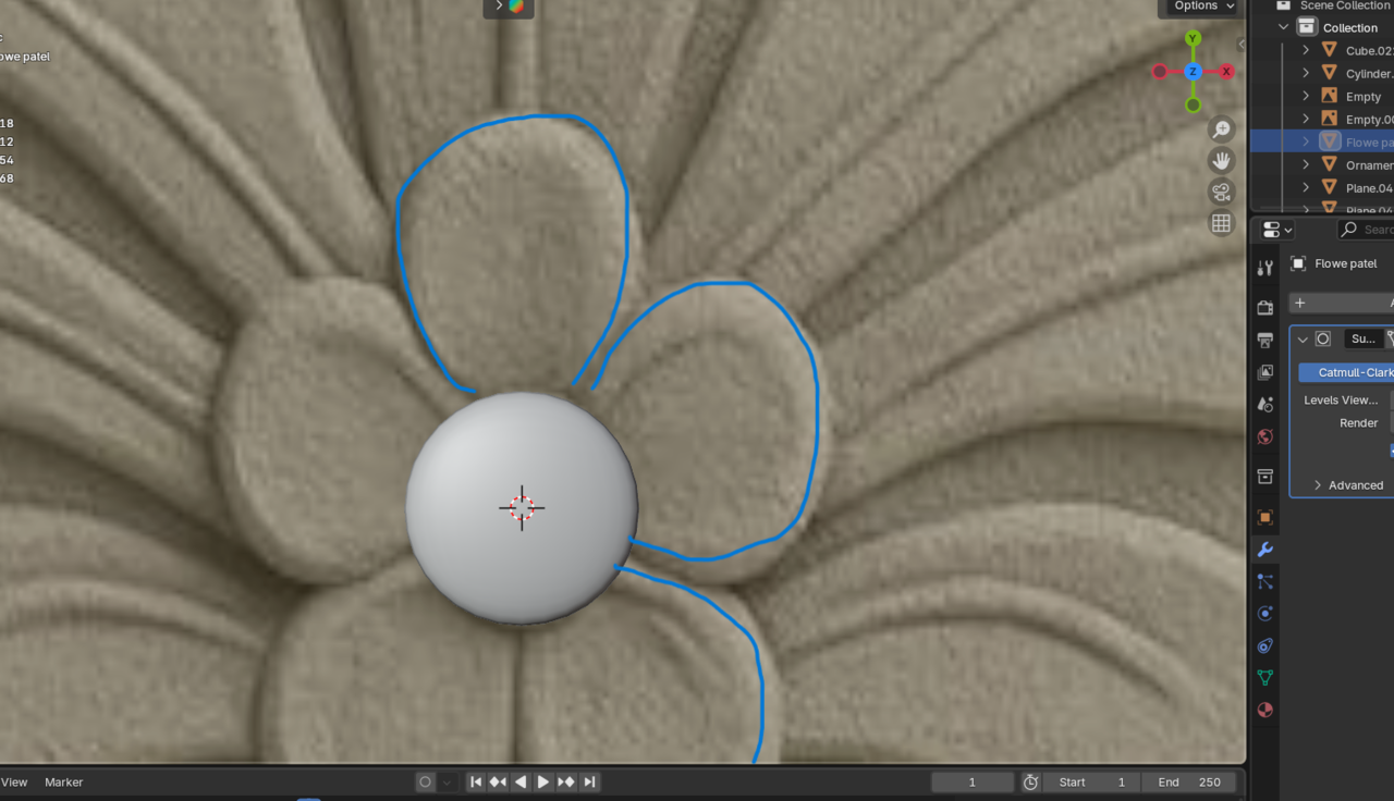

      #99289
        HI Deb,
        These petals are all different. Just start by tracing the outlines and note, that some are partly overlapping:
        Then you can Inset them and Grid Fill the inside. And give them some thickness.

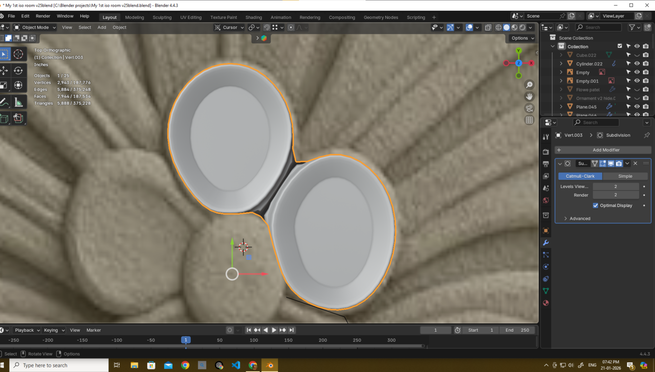

            here what i tried
            separated
            Joined

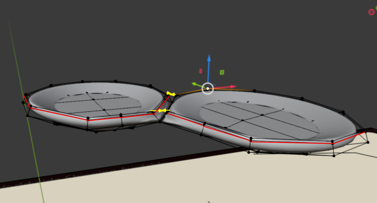

              Hi Deb
              You can either Scale each petal up a bit, to compensate for the Subsurf.
              Or Join them, but then probably ‘higher’, maybe like this:
              And I’d remove those holding Edges for now, you can re-Add them later, if needed.

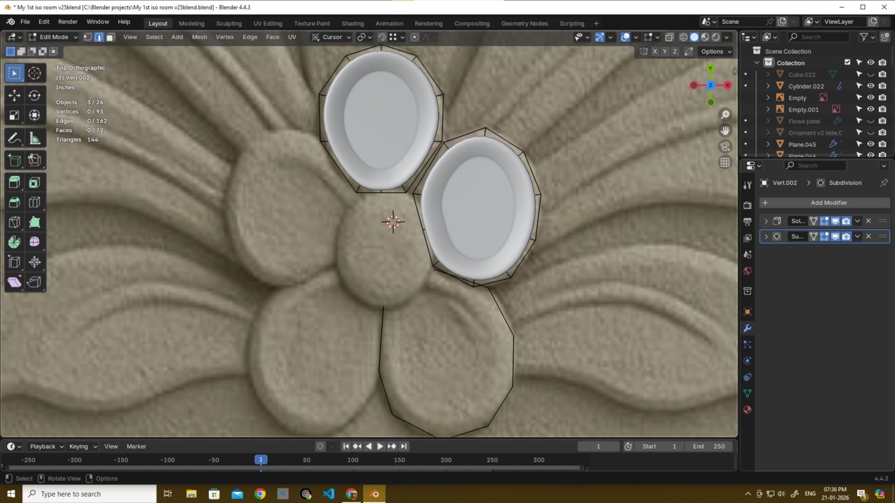

                if i choose join them what next? becasue its not looking what it should be?
                if i scale them they will oevrlap badly or have this gap and not gonna look as the ref image..

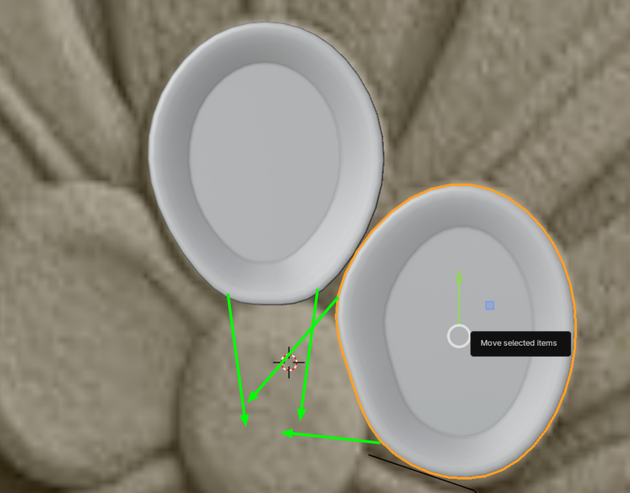

                #99294
                  You can move the inner corner Vertices further inwards, they disappear under the center anyway (intersecting Geometry is totally fine in this case):
                  Not sure about the Joined version. Definitely not the way I’d do this.

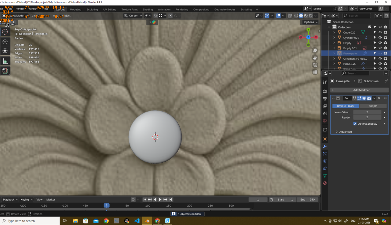

                            Those flower petals can be cheated, they go under the main center circle, so they don’t have to be a single mesh. It can be achieved much simpler and since these are part of a bigger model, a small detail wont be as important. One thing you learn is to pick your battles and where to put all the effort, like triage. If you want to make them a single mesh just for the challenge, then go for it and try your best, make all the mistakes, don’t be afraid if the result is all skewed and blobby and you have to try again, because it’s your brain that has to get the hang of this, and the intuition will come with repetition. Post it here once you are done. You have posted other models you have modeled and they look super good.
                            Also you have to watch tutorials, the lessons will answer most of your questions as teachers explains most of the stuff.

                                I am back and finished it!
                                Thank you guys: @thehomme, Omar, and Martin.
                                I wanted to tell you guys why I modeled it this way:
                                For this part, I had to find a balance. The real reference is naturally imperfect, but the rest of my model is perfectly symmetrical.
                                If I just traced the reference by hand, the result would be more accurate with the ref image and have imperfections here and there like the ref image but wouldn’t fit the clean look of the parts I already made.
                                So instead, I used circles to build the petals. This kept the geometry perfect and symmetrical (to match my style), but still allowed me to change up the shapes so they aren’t all identical. It gives me the best of both worlds: clean topology, but without that boring copy-paste look.
                                Thank you again, Martin and @thehomme!
                                This time I used both of your tips combined. @thehomme, you said to use it as a single mesh, so I did that. And Martin, you told me to merge the upper verts and remove the middle supporting loops—I did that too. Thank you guys very much!
                                Also Omar, thank you for being blunt and honest. I definitely needed that.
                                And yes @thehomme, I will finish the task Jonathan Lampel gave us soon! I need to make an isometric room with at least 30-50 objects, and I’ve already completed 17. After that, I’ll jump right into sculpting… thanks for the tips, mate!026-01-22 144902.png026-01-22 144925.png
                                #99302
                                  Looking great, Deb!
                                  A good decision to model it like this; fits the rest and nobody is going to compare it with the reference you used anyway 😉
