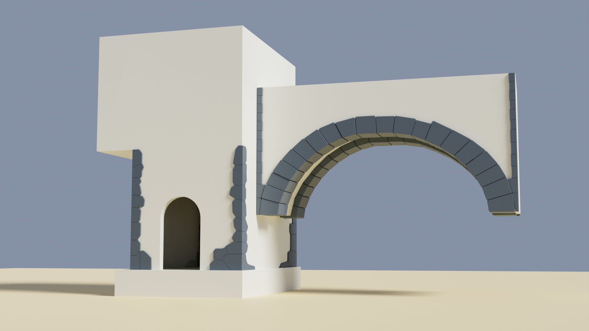

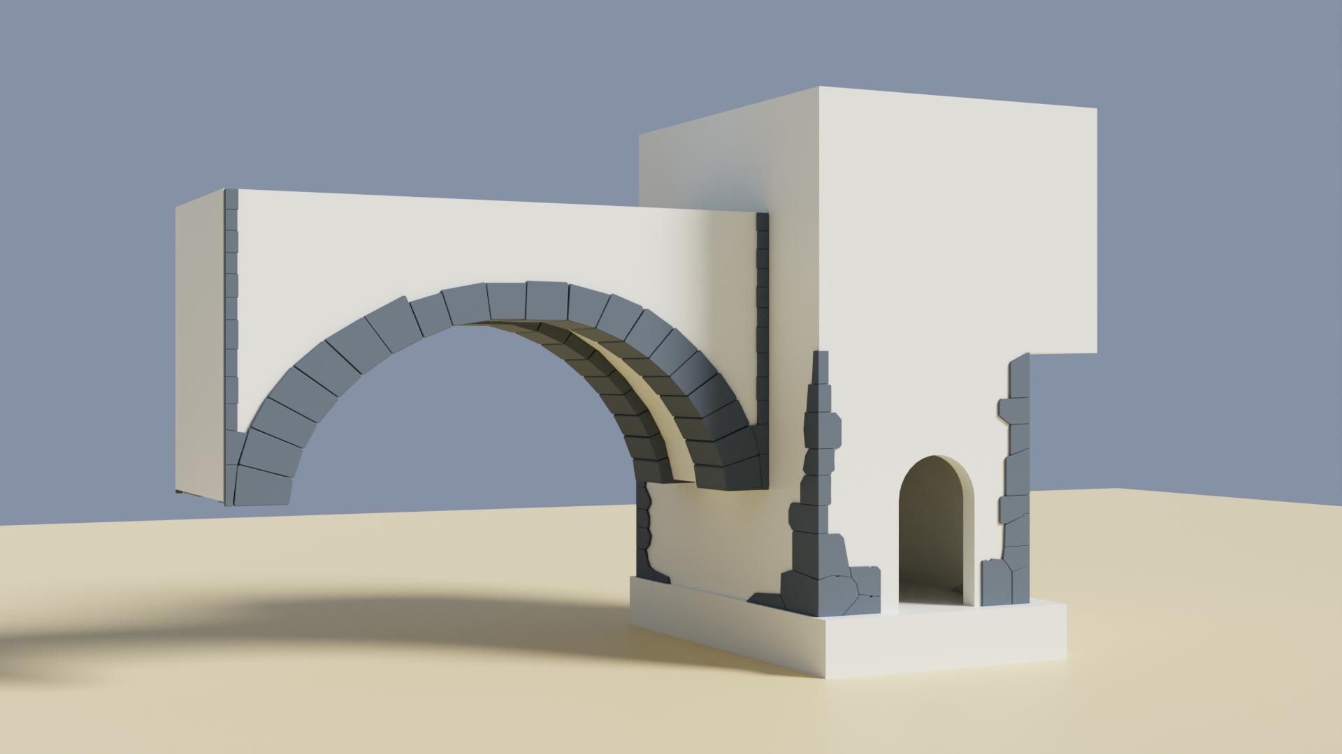

    Martin Říha
      This is my blockout of masonry accents. I did both sides, front and back.

          yukino hatake
            looking really great, love how its not perfectly even 🙂 especially those around the house looks so cool 😀

              Shawn Blanch
                That is a great first blockout in my book. Nicely done @hadiczech
                #67832
                  Excellent blockout for week 1 @hadiczech! I really don’t have any constructive criticism to add. You’ve earned full points from me week 1 👍
                  You’re on track for gorgeous sculpted accents in week 2. I’ll give you the same recommendation I’m giving the others even though it looks like you’re already doing it: I recommend you treat each accent “area” as a separate model that can be mirrored for easy population on the rear of the house:
                  Each color represents a separate model that can be mirrored to the backside. This way you won’t have to model + sculpt + texture the rear side individually. And I think all 4 of these models can share a texture map if their UVs are laid out in the same texture space. But more on that for week 3.
