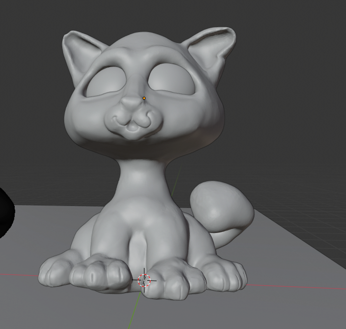

      Hi! I wonder if anyone can give me some pointers as to how to go forward with this kitty cat sculpt:

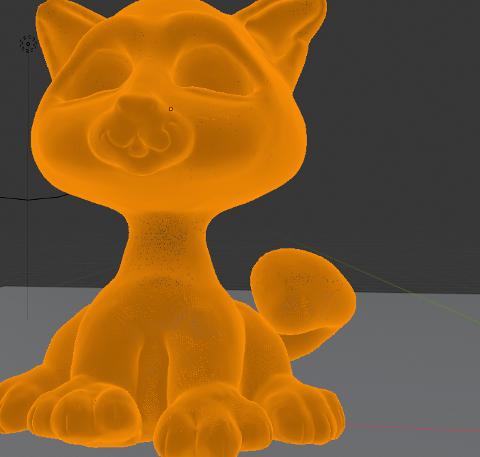

      Since it’s a sculpt, of course it’ll be insanely dense, like so:
      I know I need to retopologize it, but I don’t have much time in the evenings to do it the painstaking way. I’m also watching my funds where deciding on whether I’d like to buy RetopoFlow. I haven’t sculpted much, but I’d really like to finish up the cat and put some textures on it and some fuzzy fur. I have an idea for a cute scene!
      So, if anyone can help me out, that would be wonderful. Thank you so much in advance!

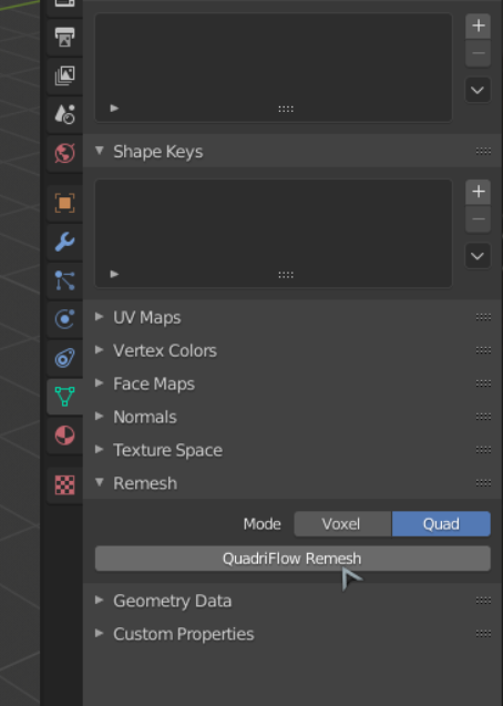

          Then use the quad remesher:
          Press the button and select the number of faces you want.

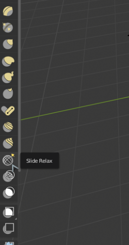

          Then you can do a bit of clean-up using the Slide Relax brush in Sculpt mode. (Do enable the Wireframe Overlay, so you can see what you’re doing.)
          This will not give you a great topology, it’s not meant for retopology,  but it’s all quads and super fast. You might even use this as a start and the do a manual retopo where needed, in case it needs a good topology.

              Hey, @spikeyxxx ! Thanks so much for replying! I was looking at the remesh feature, tried it out. Though I did the voxel side. That’s something different! I didn’t know about the Slide Relax brush! I still have plenty to learn on the sculpting brushes. Useful stuff!
              I’m wondering if I also need multi-resolution to sculpt in and bring back some details, like the mouth on my cat. Hmmm!
